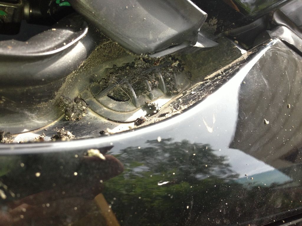

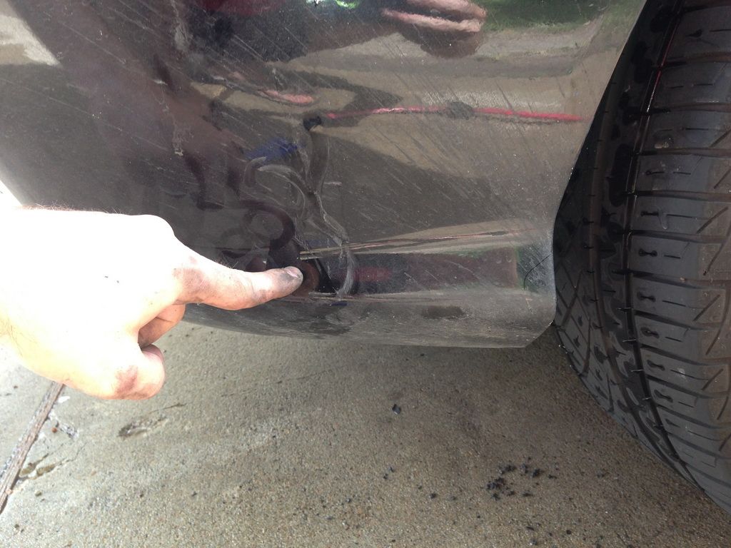

#40 · (Edited by Moderator)
Hi folks!
I'd like to share a couple pictures of today's cleaning. I cleaned my drains last year but I think I did it the wrong way. Let me share some good tips and tricks =)
At first I used compressed air from my 20 gallon air compressor. I took a piece of clear silicone tube (which came from the fluid transfer pump I used for my rear differential. You can get one from Ace Hardware store or probably any automotive store will do. Not sure about the diameter but it should fit the hole in the drain point :D) and inserted it into the back drain point on the top.
You can see this clear tube on the amazon picture. Plews 55001 Lubrimatic Fluid Quart Pump, Fits Standard Quart Bottles : Amazon.com : Automotive
Then blew compressed air and the accumulated dirt started coming out from the same point on top =)))) not from the bottom :confused:. So I traced the drain line. It goes into the inside of the car along rear fender and ends on the outside right underneath the outside of the bumper.
Can be seen here:
Sorry, there was no way to take a good shot of this place. Tried to bend but that's the best I could do. You need to jiggle wiggle with your fingers to feel the end rubber piece. Then I inserted my air compressor gun nozzle into the bottom of this drain line. 90 PSI pressure and look what came out:
Nasty, isn't it? So I blew it out and then inserted the clear silicone tube from the top and hold the other end against my garden hose handle which looks like a gun with a thin tip. And pressed the trigger to allow water under pressure.
Melnor Adjustable Rear-Trigger Nozzle 470-640 - The Home Depot
It definitely cleared the drain point =)
To clear the front ones I used compressed air from the top and the same water-pressure method. Now they are super clean :rb
And now the reasons why it gets clogged. Over the time small pieces of leaves and blooming flowers get into it and get stuck at the very bottom due to "ingenious" MB engineering. The drain line is pretty straight but it makes a "T-shaped" curve right at the bottom and the end piece comes out to be "smashed" rather than just coming in a nice round pattern. Think about it as if you squeeze the rubber tube with your fingers and that makes your water shoot further. So leaves don't have enough space to squeeze their way through an already squeezed tube and form a "bottleneck".
P.S. I don't suggest putting any kind of wire into these drain points as some people do.
First reason is that it doesn't clear the drain but rather tucks all the junk into the bottom, and makes draining even worse. The wire does reach the bottom up to the point where this rubber end makes a T-shaped connection but doesn't go beyond that due to flexibility issues.
Second, you can damage the rubber drain (cut it accidentally) and all this water will go right into your rear fender area, where the hydraulic pump is located. Not too good, isn't it? And it will require a lot of labor and disassembly to replace that rubber line. Definitely not worth it, believe me!
So get a friend with some air compressor and an $8 garden hose gun-type tip and clean them thoroughly and properly! R)
