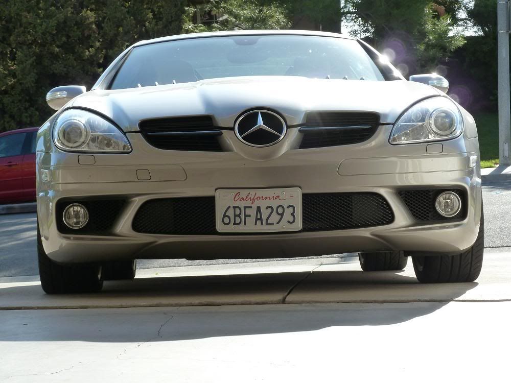

So on with the modification details. It cost me nothing other than labour as I had all the materials scattered in the parts box or elsewhere at home. There are mainly 2 assemblies:
1. The T-hook anchors
2. Simple mod to the rear of the OEM license plate folder (A171 885 09 81).

A. Making the T-hook anchors
This is the important piece as it allows one to attach the OEM front license plate holder to the lower grille without having to drill holes on the bumper cover.
Materials:
1. a pair of M4x27mm female panel connecting sleeve with its associated male machine-screw (this is used by modular cabinet makers to attach Euro style pre-fab garage storage cabinets <with 5mm series of pre-drilled holes> side-to-side, check the net for sellers of these parts, I gather the local hardware store may have them, I happen to have a pair in the parts box)
2. Wire, to make pins, about 1.6mm or 2 mm in diameter (correpsonds to one's smaller drill bits)
3. common household rubber faucet washer, one pair
Method:
1. Unscrew the associated male machine-screw from the M4x27mm female panel connecting sleeve
2. With the drill bit (I used the 1.6mm) firmly locked in the pin-vise, drill a starter hole or depression at the non-threaded end of the panel sleeve
3. Finish making a hole through the panel sleeve with a powered drill, taking great care (drill bit has to be new and sharp to make drilling easier) as the bits are sharp (wear protective eyewear) and make certain the hole is perpendicular to long axis and cuts through the center
4. Cut two 16mm-long wire pins of the corresponding diameter as the drill bit used using motor tool and a mini-vise
5. Insert the 16mm pins through the holes made on the panel sleeve (one for each panel sleeve) and secure with 5-minute epoxy
6. Insert household faucet washer at the threaded end of the panel sleeve, this is your T-hook anchor assembly
