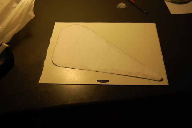

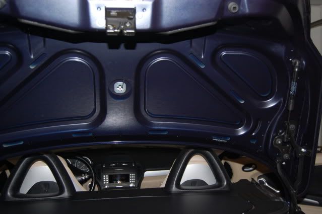

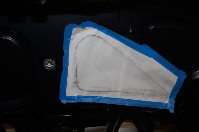

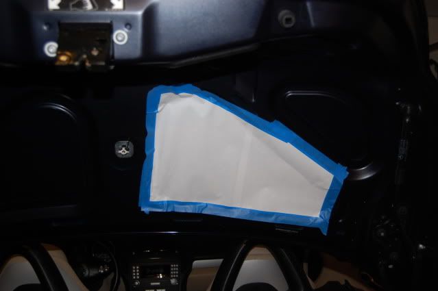

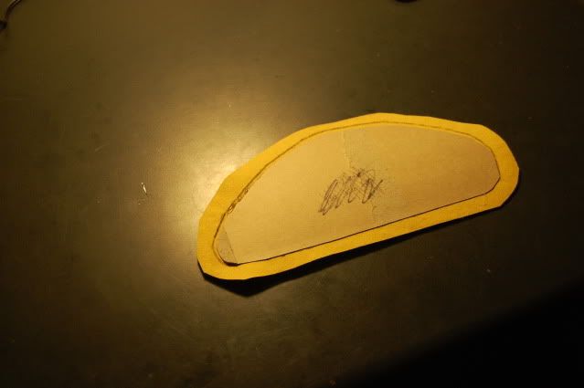

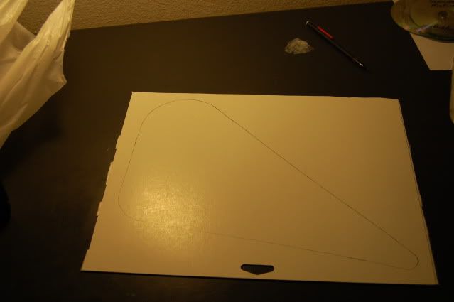

Tape paper over the large and small areas you want to make inserts for.
Using the side of the pencil lead, trace the lip of the trunk lightly going back and forth. You will see the line form in the paper. Dont press too hard.

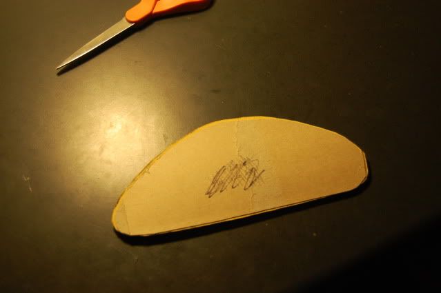

Carefully remove the paper and cut out the traced area on the line and trace onto the thin cardboard. On one side of the paper mark it Right and on the other side mark it left. This way you only have to trace 1 small and 1 large.
Next you need to cut out the template. When you do this, you need to cut the cardboard 1/4" larger. This is what holds it in place in the trunk.

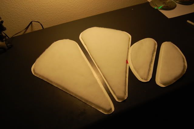

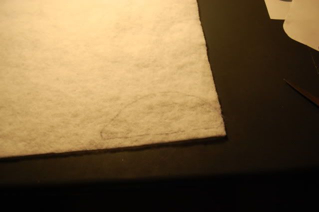

Trace the batten using the paper pattern you made and cut it out.
Apply hot melt glue to the thin cardboard and then put the filler in place and let it cool. This is what yours should look like. You can use 2 layers if you want a puffy look if you are using a thin fabric.

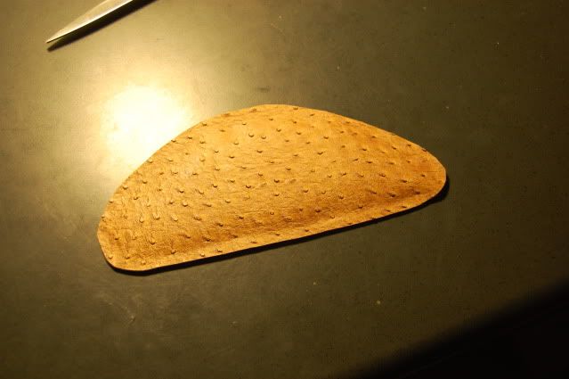

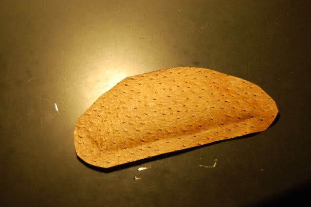

Using the template, trace on the back side of the fabric. Trim fabric leaving a 1/4" surplus all around.
Turn the cardboard facing up with the batting. To get a good seal, apply the hot melt glue to the middle of the 1/4" surplus with a single bead of glue. Quickly put the fabric over the batting and press the fabric into the glue all the way around. Should look like a Calzone. LOL
Now trim off the excess fabric back to the cardboard.
Now your ready for the install.

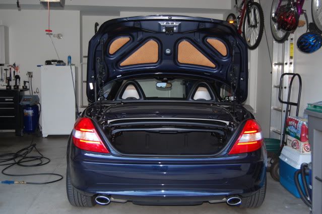

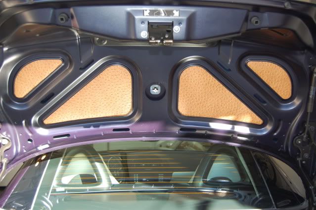

Take the insert and cup it a little bit. Slip the insert into the recessed area starting with the small corners and slowly work your way around until the insert pops in. Keep watching as you go. You might have to trim a little as you go so it fits. Take your time here, don't cut too much or it won't cover the entire hole when it pops into place.
I used faux Emu like the Spyker autos used. Its really unique.
The end product looks great!!! Enjoy
Please post pics of your custom trunk inserts
Thank you....Jerry

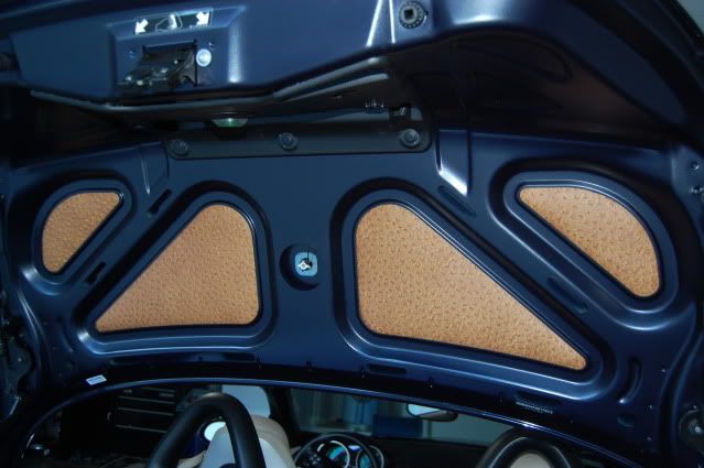

I did something similar quite a while ago in terms of getting the pattern, but did not post as I didn't think it was of interest to others. I also covered the round hole that houses the satellite radio antenna with the same material.
I used 1/2-inch thick (3/4-inch will work also) flat packing urethane foam sheets (grey colour) found in packing fruits or electronic parts and equipment. I used a heated hobby knife (soldering iron with a special attachment for blade #11 hobby knife) to effect a clean cut on the foam. The cut foam is then inserted unto the triangular and round spaces. The grey foam makes it look OEM.
Hope the photos help:

To better illustrate the trunk lid inner lining foam inserts, I've included a photo of the 0.5-inch thick foam sheet , heated knife to effect a clean cut, and the pattern; green urethane foam may be available from the local grocer :)
I'll see if I can convince Louise to plot out some templates and post 'em up.
I've also attached the scanned pattern for the 2 triangles in pdf format (print at 100%) to save members some time (just flip the pattern to create the mirror-image for the other side). The large triangle is split into two scanned images with 3 lines drawn as an aid in aligning the pattern; these two pieces can then be taped together. The pattern takes into account (i.e., included) the 1-cm lip of the areas-of-interest.
If one is following CaliCoop's method, then allow 1-cm less space all-around for the inner batten/filling.
Some minor trimming or fine-tuning may be required in the final fitting, as stated by CaliCoop.
