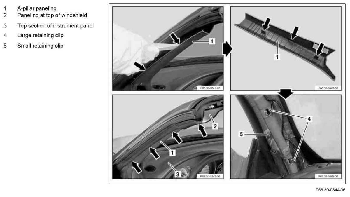

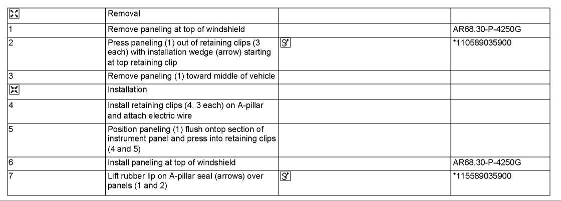

I need to remove the panel of the A-pilar on the right side and found this in another thread.
Seems simple enough to remove the panel itself, but it says "remove panel at top of windshield" with no instruction on how.
Anyone have any ideas?
I need to remove it to mount a DAB antenna
98,439 Posts
Usually you remove the 2 screws for the visors and the whole trim comes off straight across
From a search of our site:
You will have to remove both sun visors to free up the trim pieces, as they overlap the OCP. Easy - Torx screws only.
