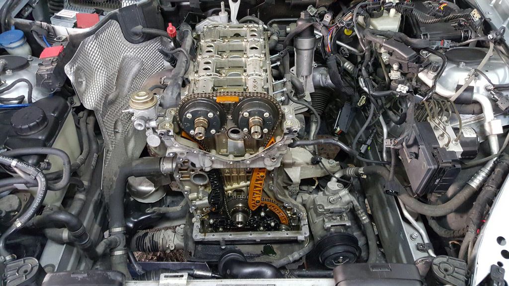

The first thing we did was strip the engine down, removing the steering pump, alternator, air filter, injector rail, admission, kompressor, A/C compressor, top engine cover with its wiring and coils and the front cover of the engine (we loosened off the sump nuts very slightly to help removing and installing the front cover, which enters between the sump and the cylinder head) to allow access to the guides, tensioner & mount etc.
On uncovering everything, I found that my timing chain had indeed stretched 1-2mm and that my Camshaft adjuster sprockets, although not badly worn, were in fact partly worn, we all know Mercedes aren't particually known for the quality of their sprockets......so the, "now that every things apart syndrome" came into play and I started looking for replacements. :crying:

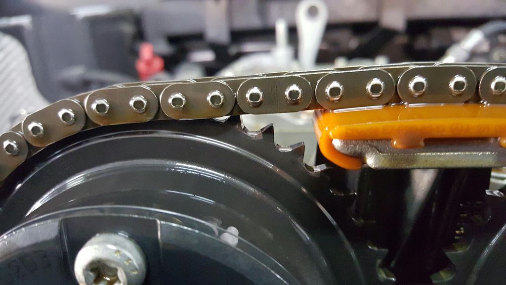

As soon as I removed the new sprockets from the packet, I could see/feel the difference in the finish from the originals, as can been seen here, along with the difference in wear,
Although the wear doesn't appear to be "very" bad, once they were installed and the new chain slotted into place, I could simply "feel/sense" the better fit. Before removing the old sprockets and chain, the alignment marks on the admission side were >1mm to the left and on the exhaust side were >1mm to the right, afterwards they were spot on, on both !! :grin:
