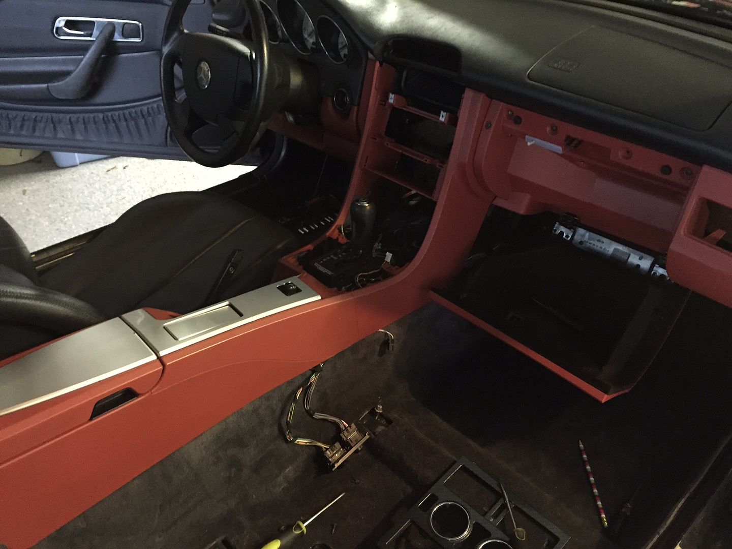

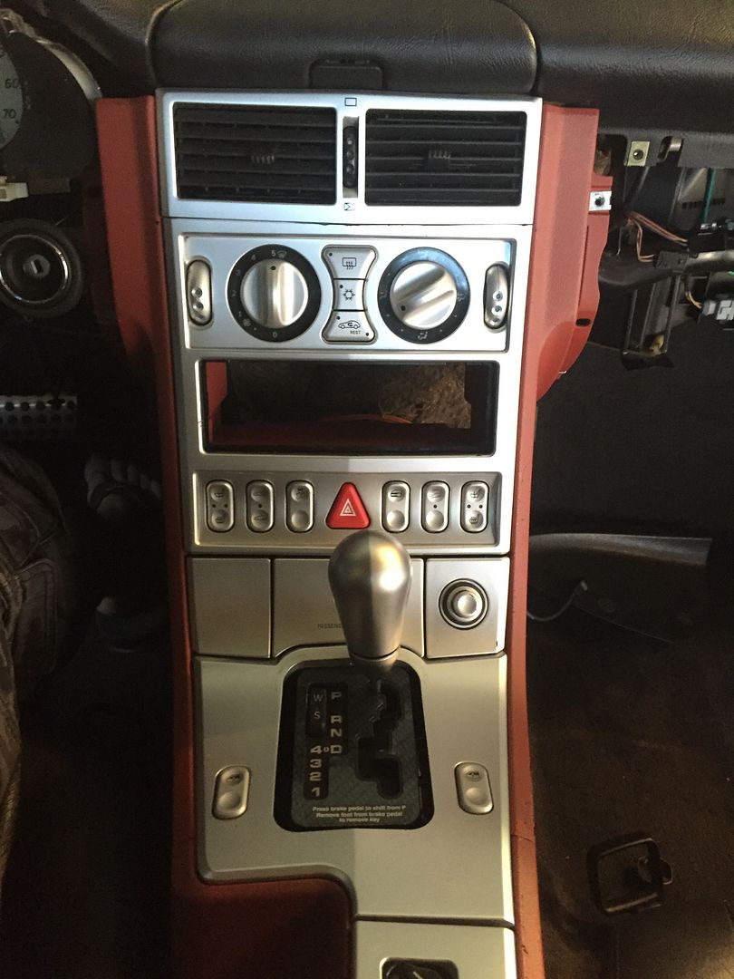

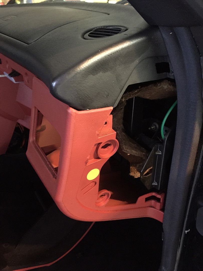

Myth busted...The panels do fit.... but not exactly perfect or without having to do some modifications. For starters the top of the upper center console needs to be cut as the SLK has the retracting cup holders which I don't believe a Crossfire comes with. 2nd the glove box assembly in the corner has some overlap and will need some trimming. 3rd is a small gap near the gauge bezel which Benz and Chrysler have completely different gauges and bezels. I will look into cutting a piece a plastic to inset and make it less noticeable
So for $250 Crossfire interior pieces will work but will require additional work. For me I needed a full interior and was not finding anything in the Benz market for a reasonable price. They are Red but I had planned on having to redo any SLK interiors I came across since most are peeling.
As far as the center console bezel pieces I have seen a post where someone has swapped the Crossfire into an SLK and looked really good so I will be heading back to the salvage yard Monday to grab that piece and panel around the shifter. If these are able to fit it will give the car a updated look and look awesome.

Did the ac controls, radio etc fit without many modifications?
The Benz bezel trim does not fit correctly but the A/C controls and radio does fit into the cavities of the console with no problems. Tomorrow I am meeting a guy who has a couple couple parts cars and I am going to pull the rest of the trim pieces I need around the radio and shifter. From what I can see so far the A/C vent alignment will probably be challenge and I will need to shorten the bezel height to fit properly, this is mostly due to the cup holder situation but if successful this will be a great looking update to the car.

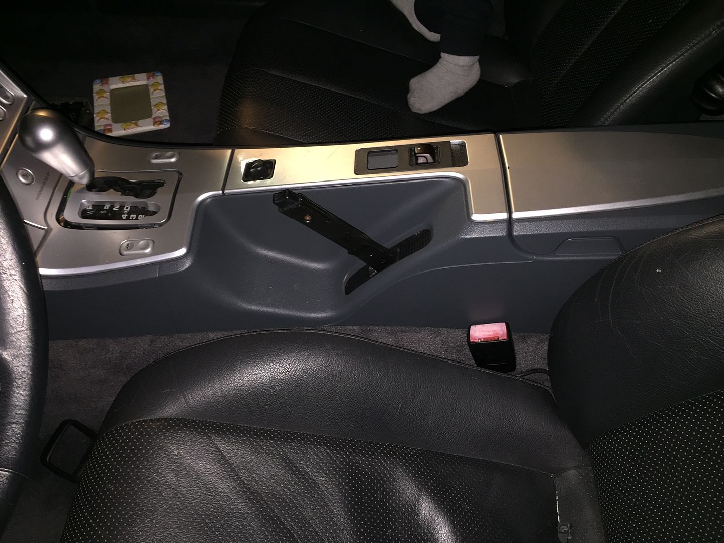

Scored all the Crossfire center pieces plus A/C controls, shifter bezel and knob for $120. Great deal on the parts considering I can now sell off my factory carbon fiber bezels and recover some of my cost on the interior swap panels.
As expected the A/C vent and radio bezel does require some modifications and you better have a Dremel handy and a pair of calipers for measuring.
I will post pictures latter of what needs cutting and filed but wanted to share this update for those who were curious.

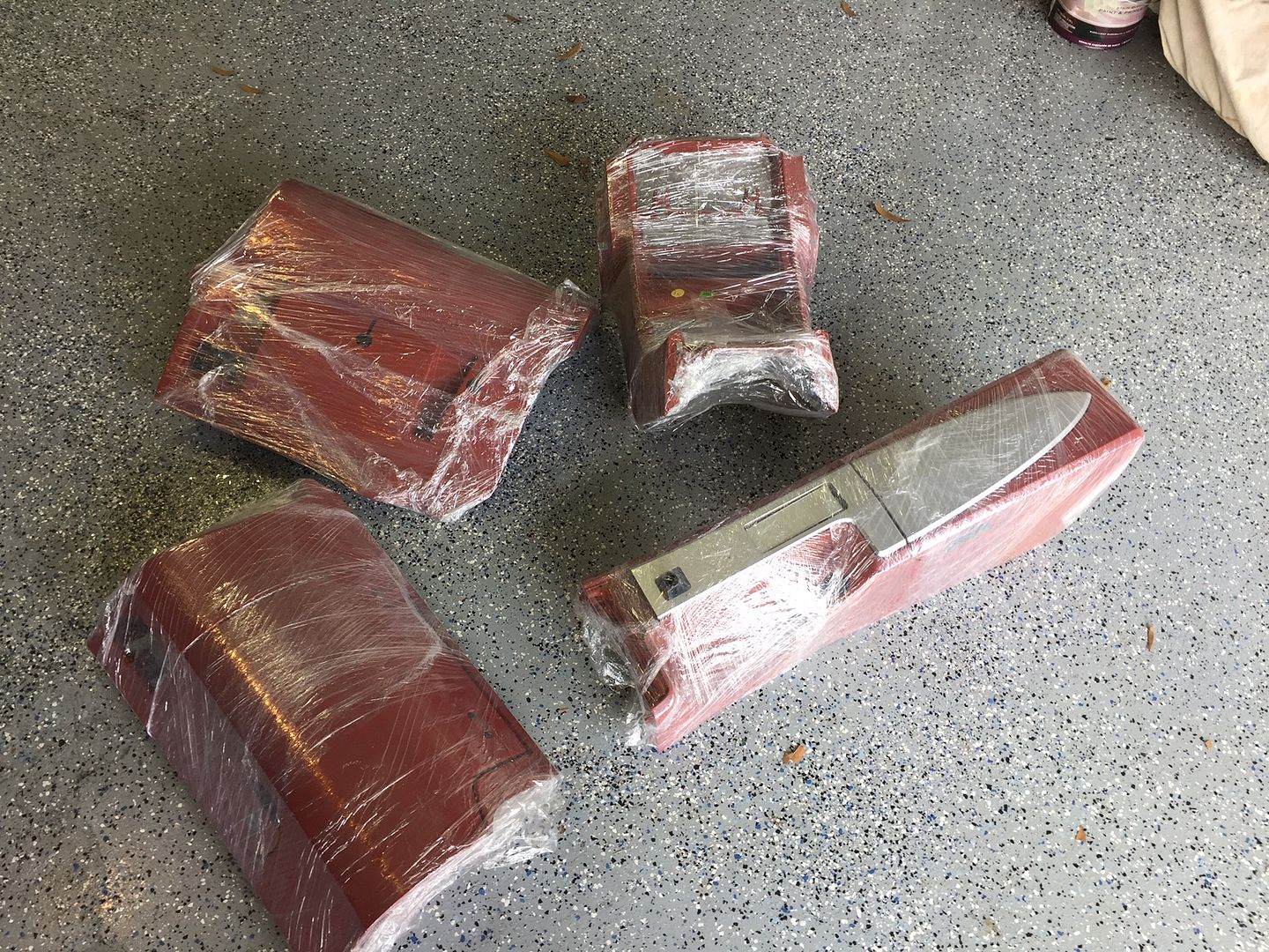

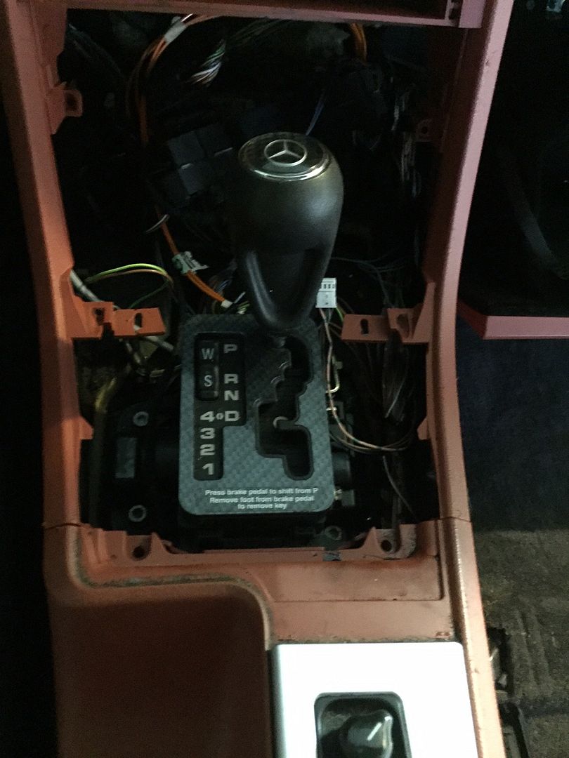

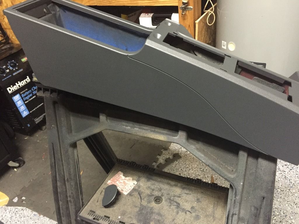

Sorry guys I was in China the past 2 weeks and just got back. Panels are now soaking in water to help lift off the red paint and I will be preparing the parts for paint/dye this week and installing this weekend. Still unsure how I will get the shifter bezel and trim to matchup, appears the shifter pattern that is cutout for the SLK and Crossfire are different. Would be great if I had the entire crossfire shifter to see if they swap out but I'm not ready to spend $200 to see if it works.

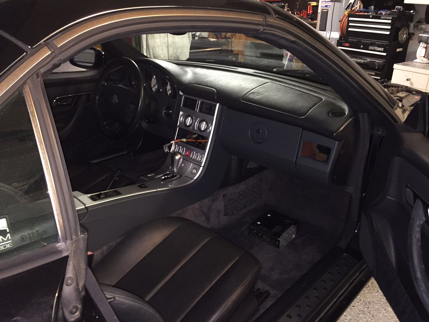

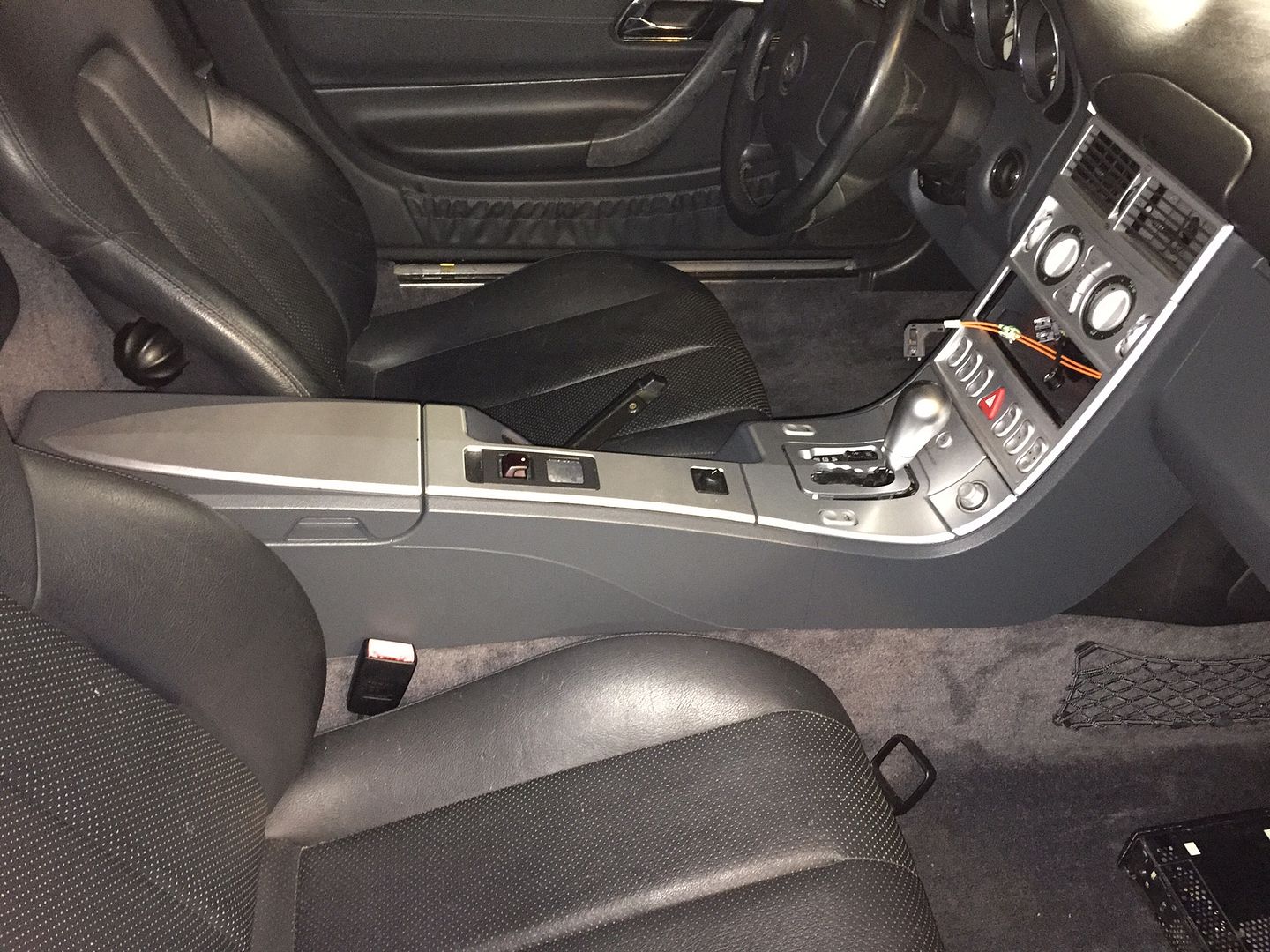

Sorry for the delay guys, I have to many projects going on around the house but I did make some progress over the weekend with getting everything painted and put back in. I went with SEM graphite paint and very pleased with the results.
See less See more
Reactions: 1
Still looking for a source on the shifter bezel and vents. Also not sure what the deal is with the gap between the glove box and the dash. Looking at other SLK's for sale on Ebay this appears to be a common problem. Is there an adjustment or tweak that fixes this?
