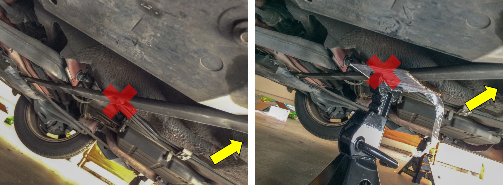

Carefully set up your hydraulic floor jack in a safe and flat surface. Unfold the pin of the jack (red arrow) and place the longer section of the jack base (yellow arrow) aligned with the surface. Insert the pin to the jacking tube opening until it reach a full stop point (green arrow).
Begin raising the jack until the maximum height by rotating the handle clockwise. When the jack is fully raised, it will stand on the edge of the jack base. In my case, the jack base (yellow arrow) will not aligned with the surface.
Place the jack stand under a strong structural component. It is located at the outer end of the diagonal bar (green arrow) for both right and left side. The point is approximately parallel to the circle jacking point (red arrow). FYI, circle point can be used to raise the car using a flat hydraulic jack. I used a cardboard between the frame and the jack stand for protection.
Raise your car unequal for both side. The higher side should be on the right side of your car. The reason behind this is because the oil drain plug is located further to the left side of the car. To be able to drain the whole dirty fluids, we need to “tilt” the car to the left. This practice also make the draining even faster. If you raise your car on equal heights, you need longer time to drain the fluids.

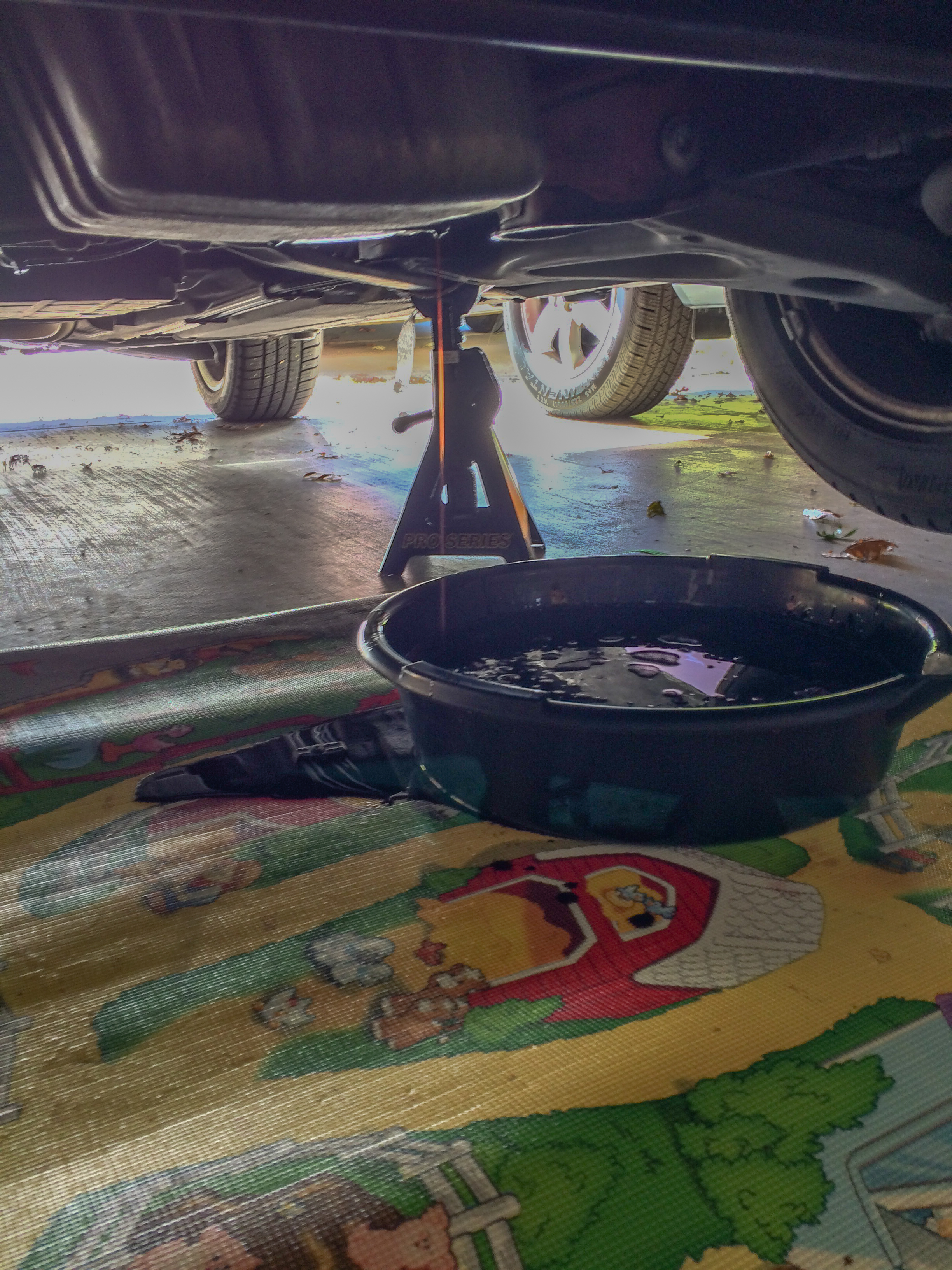

Remove the drain plug (yellow arrow for the location) from the oil reservoir (red arrow) using a 13 mm socket.
Be careful because the oil is hot. Place the drain pan exactly under the drain plug. The center of your drain pan should be aligned with the drain plug location. FYI, I did the oil change after driving around for a couple blocks to increase the engine temperature. Hot fluids will flow easily compared to cold fluids.
Set aside your drain plug if you want to reuse it. Replace the drain plug gasket with the new one. I’m sorry that I didn’t take the picture of the plug removal process.
It took me about an hour for the dirty oil to completely drained. As I mentioned before, raising the car higher for the right side should speed up the draining process as we “tilt” the car to the left.
Credit goes to my son because I borrowed his playmat for the work

  2. Raising the car with unequal heights. "Tilting" the car to the left by rasing the right side higher than the left side will speed up the drain process. Initially I raised the car with equal heights and the last drips of the oil fell so slowly. So I experimented by raising the right side higher and the remaining fluids came out faster. However, I still observed that there might be a couple drips left inside since I didn't wait until it fully stop dripping. The best time of draining the oil is probably in the night time so you can leave it overnight and fill the clean oil the next day in the morning.
  3. Use a long neck oil funnel. I used a 5 qt of engine oil which quite heavy to lift. If I use a short neck funnel like the one shown in my picture, I'll might ended up spilling the clean oil in the engine bay. I didn't take my pic using the long neck funnel.
  4. The credit for this point of my lesson learned goes to @Turdo2.
    I put the jack stand for the left side a bit further to the inside, which is directly at the bolt of the cross-braces joint. This is an unsafe practice.

I cringed heavily at your jack stand placement in the 4th picture. however, It looks like you moved them under the bolts in the other pictures. those cross-braces should never be used to support the weight of the vehicle.

@Turdo2,
You noticed it! I agree with you. The placement of the jack stand for the left side was a bit further to the inside, which directly at the spot you've mentioned. That was totally unsafe and that is my other lesson learned.

Just some notes:
1) I loosen the oil filter cap about 1/8 turn before doing anything. Sometimes they can be recalcitrant & easier to loosen while on ground.
2) My driveway slopes down so I use a pair of 12,000 lb Rhino Ramps facing down, when I drive the car on it is close to level.
3) Then remove all bottom covers. Put screws in a magnetic cup.
4) Next I put down a layer of newspapers, then a 36x48" drip pan and preposition a 10 quart drain container on a 4" stand, two gallon ice tea jugs and a funnel.
5) Open drain plug so spent oil goes into container.
6) While oil is draining make sure the spent oil continues to go into the container, the arc will change.
7) Remove oil cap and oil filter assembly (plastic part is different for a R170 and a R171 but use the same filter - MANN HU-718/5X which includes the O-rings for both). Also need two 5 quart jugs of Mobil 1 0w-40.
I usually disassemble and reassemble the plastic filter assembly and replace O-rings on a table. Be gentle, replacements are available but about $60.
When done replace the filter and drain plug, add about 7 quarts of the Mobil 1, replace covers after checking for leaks and drive off ramps & let idle for a few seconds. Shut down and put everything away. Pour used oil into gallon jugs for transport to Wallmart (they dispose for free). Then check the oil level. Bring to top but do not overfill. Generally for me that is a total of 8 quarts.
Do not need to play Godzilla on anything, surfaces mate on O-rings and need only enough torque to hold in place and not unscrew.
BTW I do not trust the included jack except in an emergency. Use hydraulic jacks instead. R171s need the rubber adapter to avoid damage. Do prefer the ramps for oil changing.

If you wish to make any correction (eg the jack point post 4) you can.

Originally Posted by Padgett View Post
Just some notes:
you're driveway is perfectly sloped for just letting it drain into the street! no need for newspaper

a) if I did, the HOA would get upset, I use one of these.
