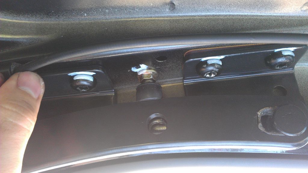

First thing you need to do before removing the rubber support is to mark the position of the nut with a marker. Make sure you perform this step to allow for proper position of the rubber so it won't smash or be in the air.
Then you need to remove 4 bolts on each side that hold the roof to the metal mountings. To do that you will need 30 torx as far as I remember. Release the tension from the screws until it starts unscrewing freely but do not remove them! Do both sides. Now, the most important part! Start pressing the roof switch in small intervals. Watch the top hydraulic locking cylinder lock disengage and unlock the roof. As soon as it starts opening release the switch! HINT: One thing that may help further is releasing the pressure from the hydraulics system.
Take a look at this picture. It's the left screw of "bronze" color.
The tool is located in the plastic panel that covers the access to the passenger's tail light from the trunk.
Start unscrewing this nut counter-clockwise until it stops.

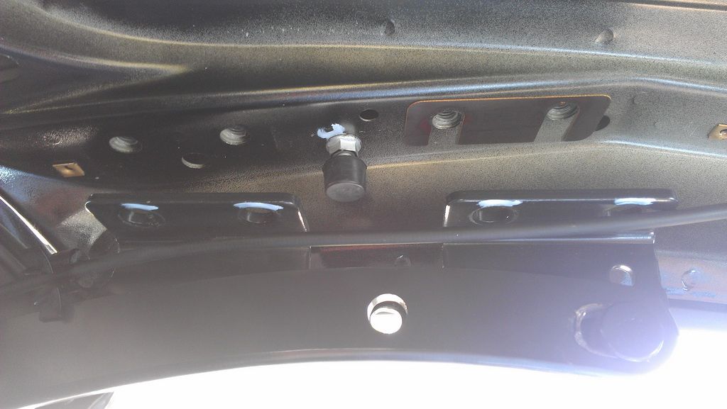

You will notice that the pressure is released and the metal support bars can be pushed manually back and forward a little bit. Unscrew the 4 above mentioned screws (Remember which one goes where since the have paint markings on how tight they should be!!!) and since these metal support bars will have a play you should have a room to unscrew the rubber support. Simply unscrew it. I think it's a 10mm. Then take your new support, hold it side by side and mark the position on the new rubber support. The next thing I did is that I transferred the old "yellowish" nut onto a new rubber support post since it has the paint marking on it on how hard to have to tighten it. It's seen from the picture.
Asyou can see from the picture I used the new bolt but later I changed it
Screw it back in and tighten it. Do the same with the second side.
Align the metal support and screw 4 bolts back in. I would recommend not tightening these all they way until you have all 4 of them in place and align the roof properly!
Now tighten those! Make sure the alignment is correct! Rescrew the pressure bolt in the trunk. Check if you roof is working!
